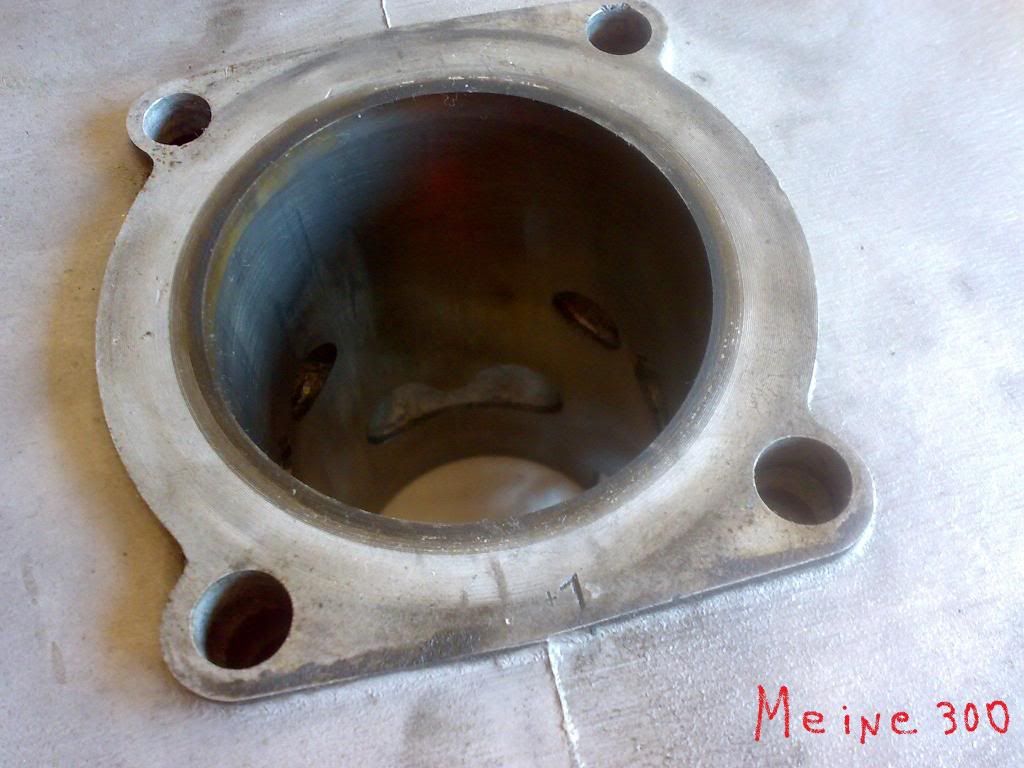

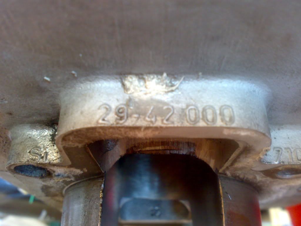

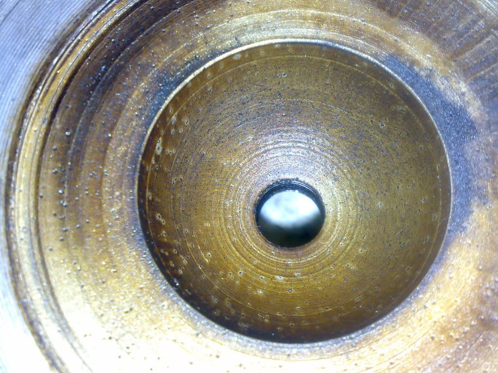

hello friends. My cylinder etz 300 and piston are blowed. I need help it is my first etz and do not know much about it. Here are some photos I put someone guide me. I need to know if there is any web store that makes the repair of the cylinder for the rectification of dieametro shirt. I have also the doubt, because my cylinder has not the same construction in that part of the junction with the cylinder head, mine is flat. The flatness is pretty good at first glance on the cylinder head. Also need to make a new thread on the exhaust valve.

Your 300ccm cylinder is a big bored 250 cylinder. Thats why the you can't see the alignment on top anymore.
You might buy a spare piston from Guesi (mzsimson.de) or another spare supplier and bring cylinder and piston to a grindery or engine renewal firm.
The marks on the cylinder cover aren't an issue, the same with the 2 rips in the scavenge transfer port.
