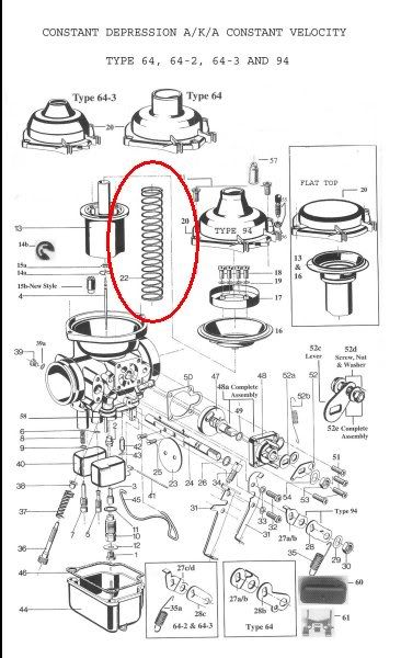

BeitragVerfasst: 17. Oktober 2011 18:40
Registriert: 23. Oktober 2009 21:58
Beiträge: 194
Wohnort: Sweet Home Alabama, USA
Order part number p/n 60 306 from Bing (circled in picture), diaphragm return spring. It was missing from by Bing 64 carburetor. It will help very much on cold starts.
-Donny
